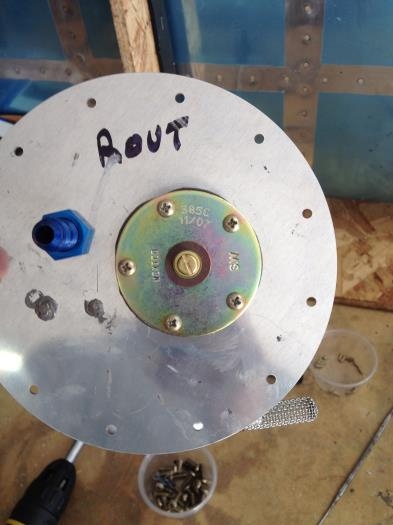

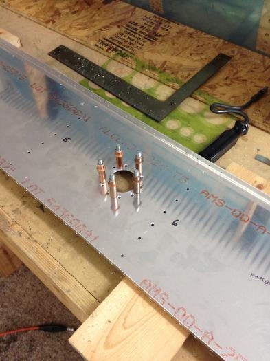

Brief Description:  Fuel level senders
Drilled a hold in the left baffle for the fuel tank sender. Since I am using a flop tube in the left tank, I had to move the fuel level sender to the second bay. Drilled the hole and the nut plate attach holes. Back riveted the nut plates in position. Then attached the right and left fuel senders. Bent the float wires to fit.
Left fuel sender hole
