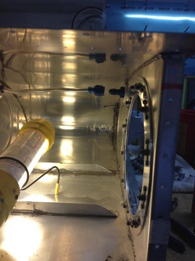

Started by installing the vent tubing in the left wing tank. I figured I would screw up so I left the line as long as possible. Used the new flaring tool. Then I went to slip on the fittings. Doh. Used the little cutter to take off the flare, installed the fittings, flared and hooked up. Didn't look right. I had put the little sleeve fitting on backwards. Cut off the flair, put everything on the right way, flaired and tightened the fittings. Time 1.5 hours. Put the vent line in the right tank. Time, 10 minutes.

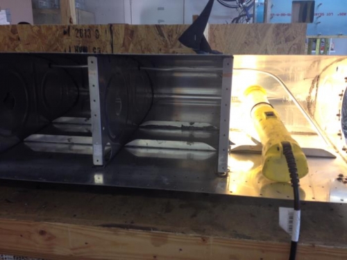

Had to trim the support bracket a little to fit around the rivets in the leading edge. I ended up countersinking one hole in the left bracket so I could use a flush rivet so I could easily install the nut to hold the flop tube in place.

Tubing installed
Tubing installed

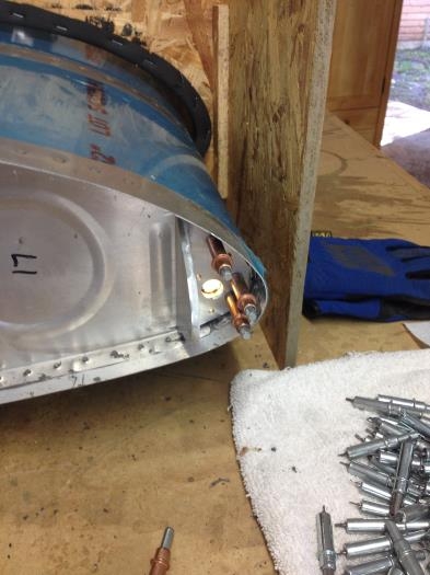

Note the fittings. The backward fittings
Support bracket installed
