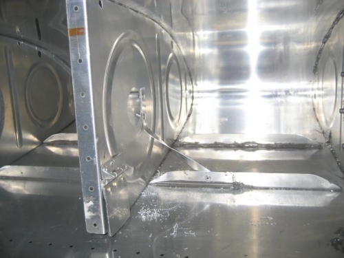

Made and installed an anti-hang up tab in the left tank where a flop tub will go. Sealed the flanges. Went to install the angle in the inboard leading edge of the tank and it can't fit around one of the rivet heads. I will have to let everything set up and then measure where/how much to remove from the angle.
