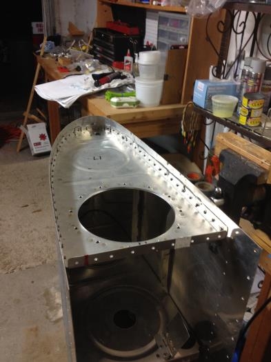

Finished riveting the left tank.

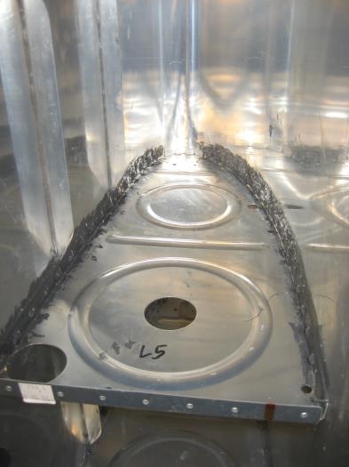

I had left over sealant and decided to test the acid brushes for applying the final coat of sealant on the ribs. I found that you have to trim them down quite a bit so that they are about 1/2 inch long. Makes them much stiffer and the sealant goes on much easier.
Riveting
Riveting

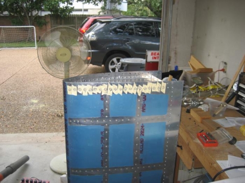

No cleco's
No cleco's
Sealing ribs
Sealing ribs
