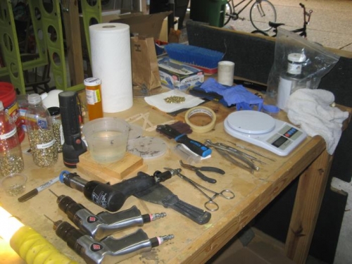

Brief Description:  Riveting setup
Stuff I used
Scale to mix sealant. Vinyl gloves. Double glove and expect to use lots of them. I would basically throw out anything that the sealant touched as it is very sticky and quickly gets all over the place. I used a metal spatula and popsicle sticks to measure out the sealant.
Lots of MEK. Masking tape, Lots of paper towels. Forceps, dental picks, cleco pliers, etc.
Also make sure to get a bright work light to stick inside the structure. Trying to rivet in the dark is bound to end badly.
