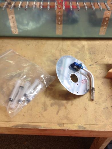

In the meanwhile, ordered syringes online and a second pint of sealant. I will probably have too much but at $40, I'd rather have left overs than not enough.

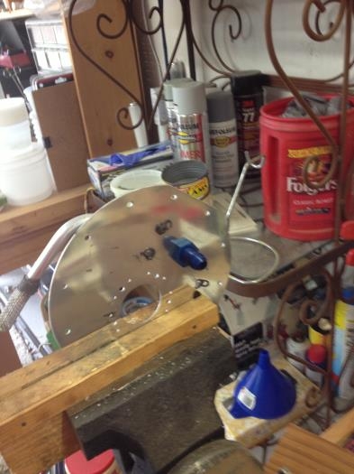

It took a little while to get the fuel pickup tube oriented properly and I mangled one of the support brackets.
I mixed a couple spoonfuls of sealant and first job was riveting the support bracket. I used the syringe to put a 1/16" bead around the base of the bracket where it would sit, then a bead around the base of the rivet factory head. There was a lot that oozed out when riveting but sealed up and cleaned up with MEK.
Syringes
Syringes
Fuel pickup in place
