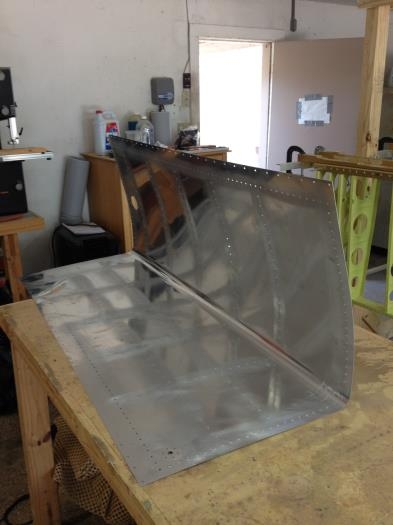

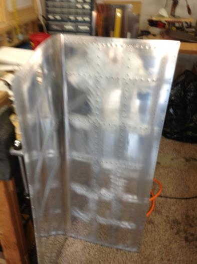

Brief Description:  Cleaned skins
Cleaned the insides of the skins with MEK and then scored the areas to be sealed with scotchbrite pads.
There are some stains on the inside of the skin where I dropped sweat onto the tank. It being Houston in the summer, average temps in the garage are 90ish (32 C) so this is a constant problem.
I thought about acid etching everything but in the end decided not to. A couple of passes with MEK and scotch brite seemed to do the job.
Right tank
Right tank
Left tank
Left tank
