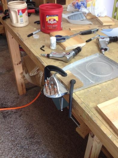

Brief Description:  Tank end ribs
Drilled the T-405 tank attach brackets and the reinforcement plates. The left plate will be modified to accomodate a flop tube fitting. The right plate will use the standard pickup tube,
Used a fly cutter to cut the two holes in the end ribs. Deburred the T-704 and T-708 end plates and ribs.
Drilling T-405
Drilling T-405
