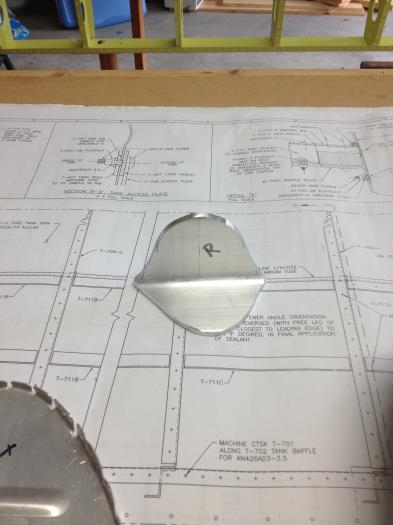

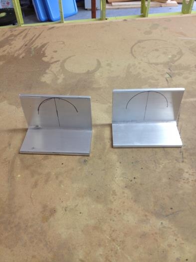

Created the two T-405 tank attach brackets. Started by making a cardboard template of the wing rib tips. Used that and a plastic circle template to make the big cuts on a band saw. Smoothed out with the scotch brite wheel.
Marked up
Finished Bracket
