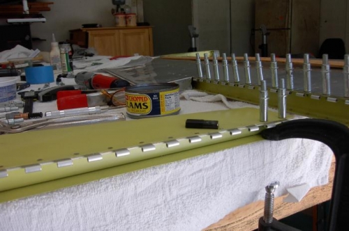

Brief Description:  Riveted Trim Tab Hinge
Riveted the hinge onto the trim tab before the first of this weekend's many baseball games. The gizmo worked perfectly.
I had one rivet hole that got enlarged drilling out the old rivet. I was able to use a AN426-4 rivet instead of a -3 rivet of the same length to fill the hole.
Ended up working well
Partially riveted hinge
