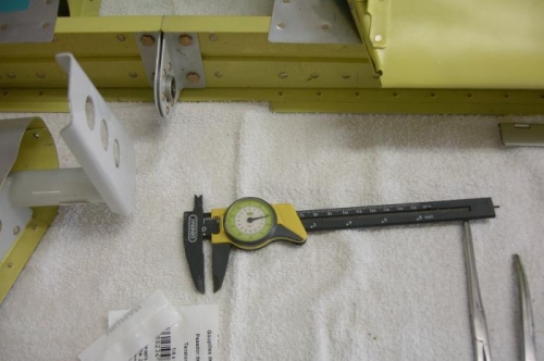

Wanted to drill the elevator horns while everything was on the HS. No such luck. Finally found a 0.25" spacer to protect the bearing while drilling. Went to put it in the pivot. Don't fit. Hmmm. Turns out the bearing has a 0.22" diameter so tomorrow off to the hobby shop to try to find something that will fit.

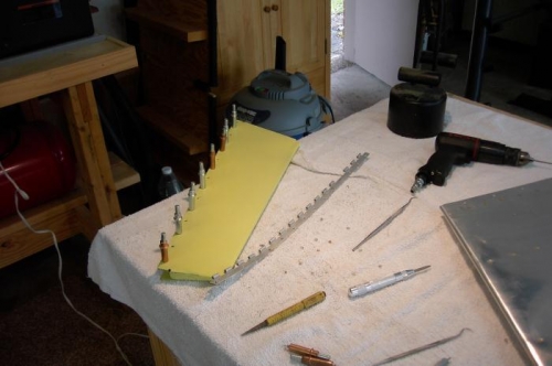

In the meanwhile, I decided to drill out the hinges for the trim tab. They weren't lined up that well and I had crushed one of the lugs with a bucking bar. So I ordered more hinge and started drilling. Two hours later, had the whole trim tab apart.
I have to make a couple of Mooney parts while the Mooney is down for annual so I will have to come back to this on Friday.
DOH - not 0.25
DOH - not 0.25"
Trim tab cleaned up
Trim tab cleaned up
Elevator drilled out
