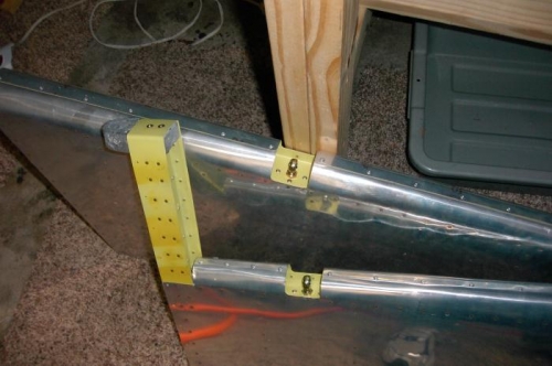

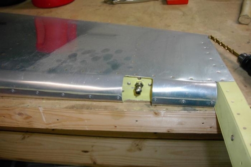

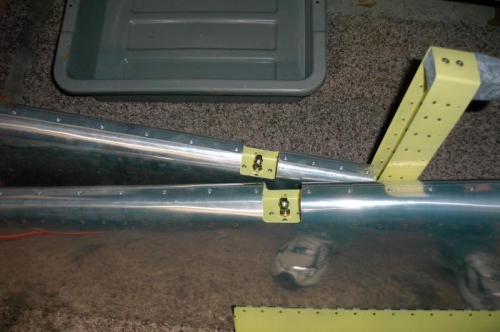

Well the Heim bearings went into the elevators correctly but on the rudder the bottom larger one wouldn't fit. Seems the hole I had drilled protruded ever so slightly out into the way of the nut plate which stripped the threads of the bearing. Had to have Luke read me the part number to order a new one. I trimmed the hole so everything lined up perfectly but had to wait a week for the bearing to arrive.
Got it today and it installed so all the bearings are ready to go.
