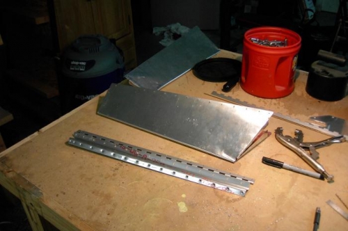

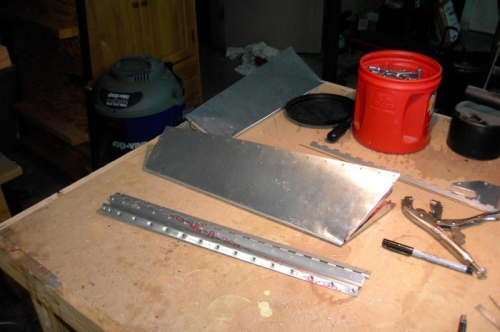

Trim Tab Hinges
After the bends were made, cleco'ed it all together and drilled out the holes, countersank the spar on one side, and match drilled the hinge that will attach to the trim tab. Start with the metal prep tomorrow.
