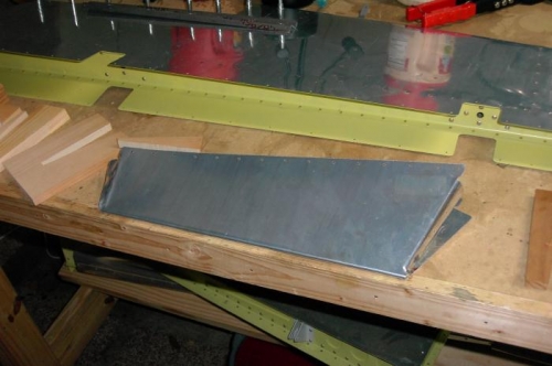

Screwed up the first non minor thing. I had finished riveting the elevator. Got out the trim tab and started to set it up for bending. I had bent the tabs on the elevator in a somewhat different manner than the Van's manual advised. I wanted to use the same fittings to bend the trim tab.
For some reason I was not being as careful as I normally am and just started plowing ahead making it work. I clamped the trim tab in the wooden V fitting I had used on the elevator. I put the wooden cutout inside the tab, clamped it all together and started bending. Well, I hadn't clamped it very well and it started slipping. Rather than stepping back and restarting, I tightened the clamps and kept going.

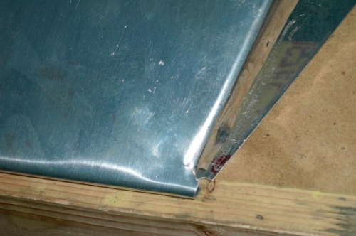

Long story short, the wooden blocks slipped and I ended up bending the tab significantly behind the bend line tearing the skin as a result. Thank goodness it was an $18 part.
Lesson learned. When in doubt step back and re-read the manual. The new part is on order and this one will be used to test the Van's approved method for bending.
Trim Tab Bend
Trim Tab Bend
Tear in the skin
Tear in the skin
