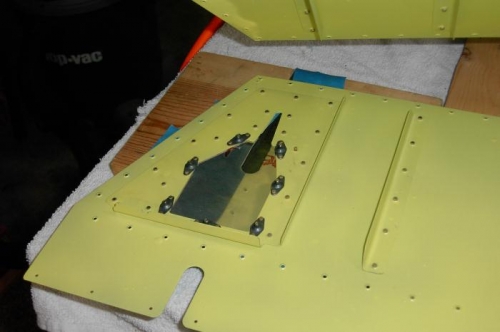

Assembled the elevator trim reinforcing plate. Dimpled the holes for the cover plate. I used some Boe-Lube on the screws to allow the screws to go far enough into the nut plates to fit the cover plate flush. Then back riveted the reinforcing plate into place.
The cover plate fits flush. I removed it for deburring and priming which I will do along the trim tab.
Nut plates in place
Nut plates in place
