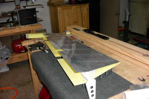

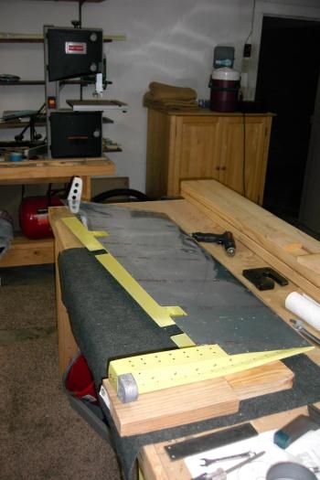

Date:  9-16-2011
Manual Reference:  6-10
Brief Description:  Riveted Right Elevator
Finished riveting the right elevator together. I was able to use the thin rivet squeezer for all but the last rivets near the back of the elevator. For those I used a piece of 1/4" steel as a bucking bar and it worked okay. Have to roll the leading edges tomorrow. Going to use "Gorilla Tape" as it was recommended instead of regular duct tape for rolling.
