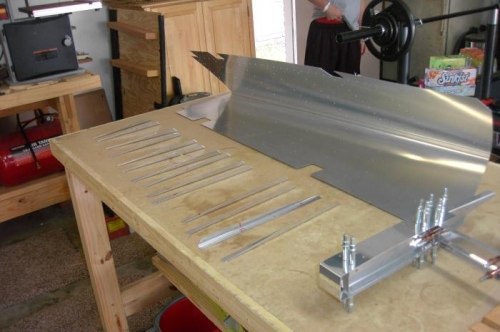

Cut the stiffeners. Tried band saw first with a little piece of wood under the stiffener but it chattered way too much. A half inch hardwood scrap worked great, no chattering.

Cut all the stiffeners

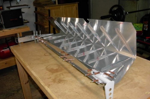

Cleco'ed together ready for drilling
