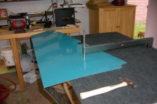

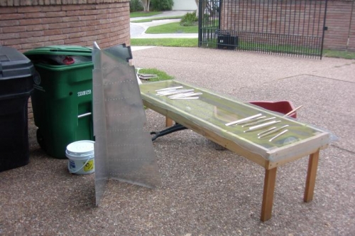

Drilled the skin and the stiffeners to #40, then dimpled the skins/stiffeners, Deburred the holes as well as the edges. Finished sanding the cuts on the stiffeners to smooth. The washed everything with soap/MEK. Finally acid etched with Alumiprep and let dry.
Dimpled
Dimpled
Washed with soap/MEK
Acid etched
Acid etched
