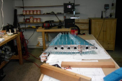

Been a week. Re-organized the garage and took my BFR in the Mooney.

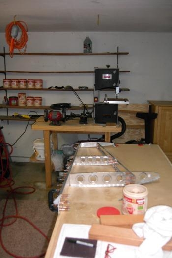

Cleco'ed together the Rudder frame and drilled out the hinges and the spar doubler. This part went easily. The cleco'ed the skin on. It didn't fit nearly as easily as the HS skins but it eventually went together. The noise/heat is an issue. Now that summer is here, need to work in the early morning and evening. May have to figure out some sort of A/C rig so I can keep the doors closed.
Spars and ribs cleco'ed
Drilling the skins
Drilling the skins
