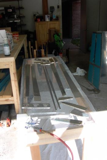

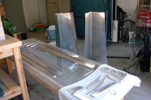

Cleaning parts in preparation for priming. Using Dawn and then wiping down with MEK to get everything clean.
Used Alumiprep 33 to clean and etch the parts. I brushed Alodine on the parts per the directions but wasn't happy with the results. Next time I will use a tub to immerse the parts completely for the requisite three minutes.
