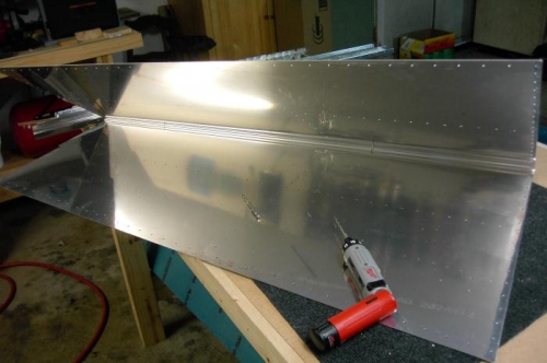

Deburred both elevators. Used a soldering iron to remove the plastic in strips along the holes.
I find that a large drill bit in my electric screwdriver at low RPM is perfect for deburring holes. A quick shot and it turns 1 or 2 rotations, Works much better than the purpose built deburring tool.
Deburring inside of elevator

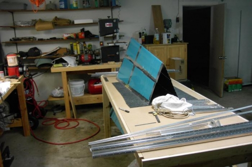

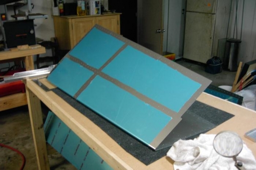

Removed plastic
Removed plastic
Everything deburred!
