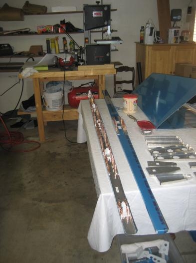

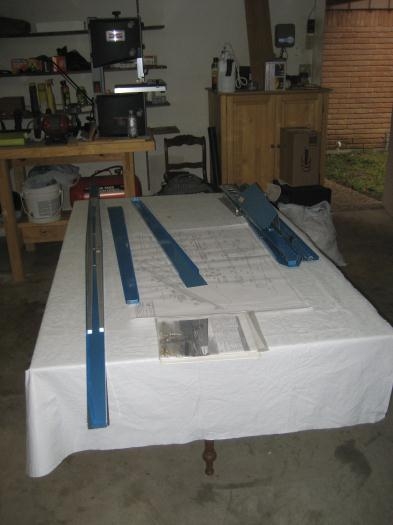

After a long hiatus, a change of jobs, and finishing some of the garage, got started.
Sorted out parts for the rear spar assembly. Filed the edges of the HS-609PP spar reinforcements, cleco'ed brackets, and drilled to #30. Drilled out #21 holes. Riveted the elevator bearings.
Rear Spar Parts
Rear Spar Parts
Cleco'ed together
Cleco'ed together
