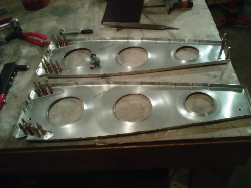

Brief Description:  Completed aft ribs, started nose ribs
I completed the last aft rib(s) #1 L & R.

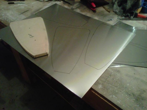

Getting ready for the tib ribs. I made a crush block out of MDF (because the sonex supplied form block will chip). Here I have used the form block to mak eanother form block 1/2 inch larger for patterns, BUT I do not think the flange will be larger enough after the bend, some I am going to re-draw the patterns using the washer meathod I used for the aft ribs. Basically use a washer that is 5/8ths wide from the inner hole to the outer edge and draw a line around the form block. Then cut out.

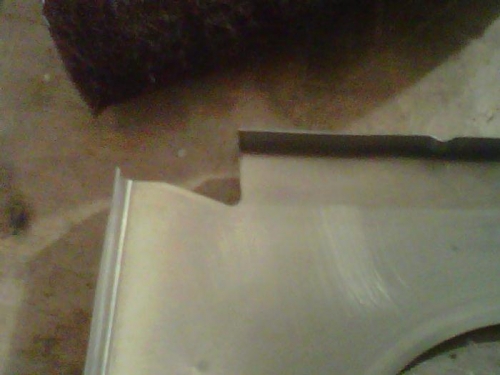

Offset for spar caps
ready to rivet
ready to rivet
oversize formn block
