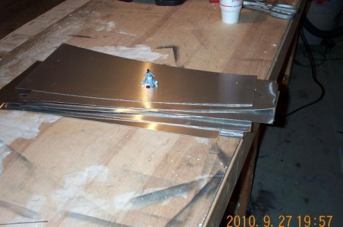

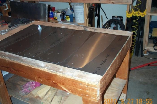

Cut 18 additional rib blanks and drill alignment holes. Ready for the router tomorrow.
Layed out yesterdays rib blanks on .025 sheet (I get 5 across) and marked a line to cut with the shears. I then marked the alignment hole using one of the blanks and a center punch, then drilled.
Yes, that is Eeyor supervising the work.
