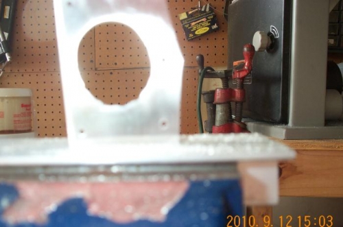

Reworking snx-w13-04 (2 each) -01(r). Used tracing paper to transfer image to part and used rat tail file enlarged/elongate center hole on both parts. Then used 1 inch sandpaper drum and wheel to polish out.
Rebuilt W12-04 (2 each) from scratch using tracing paper template.

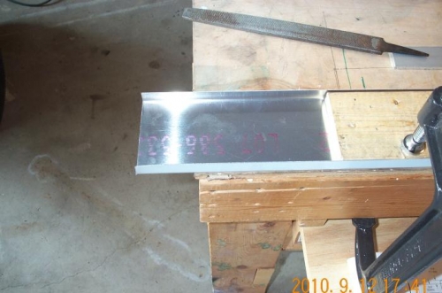

Started SNX-W12-01 R, rear wing spar. Cut to 95 3/4 inches as well as 3/16 offset on top of spar. Filed and deburred cut.
W13-04 cut to size, filed but not yet polished
W12-04 and template
W12-04 and template
W12-01 R cut, filed and deburred
