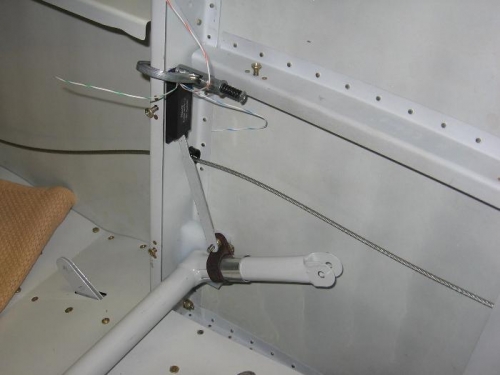

Brief Description:  Flap position switch installation
Today I tinkered with the installation of the flap position switch. I positioned a clamp on the flap torque tube crank and fabricated a link so that as the crank moved the link would move the position switch input arm. The trick was to get the clamp at just the right distance away from the center of rotation of the flap torque tube to provide just the right amount of position sensor travel. It took some fiddling but I believe I found the right position.
Ray Allen pos-12 position switch installation
