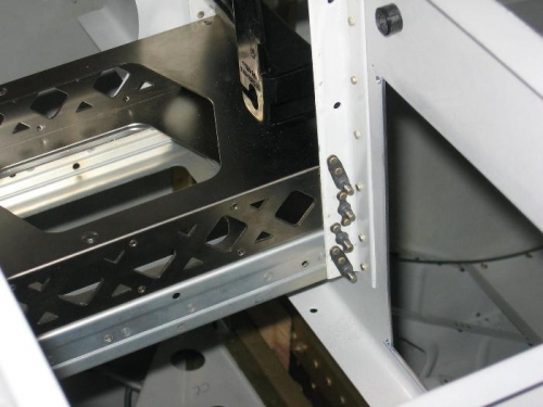

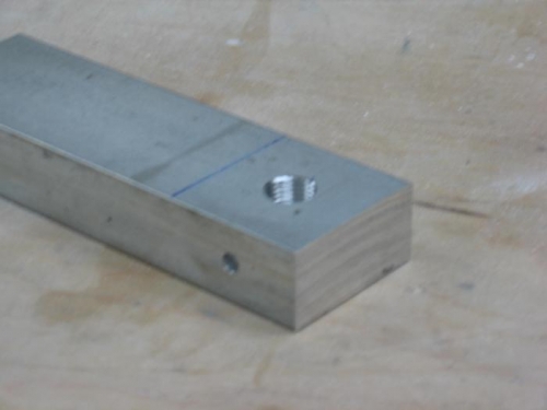

Today I installed anchor nuts on the radio tray support angles to secure the radio trays. I also began to fabricate a distribution manifold for the engine manifold pressure for distribution to the left and right electronic ignition and also to the display system for setting of engine manilfod pressure. I used some bar stock, drilling and tapping four holes to accept AN fittings.
Radio tray support angle anchor nut installation
Engine manifold pressure distribution manifold
