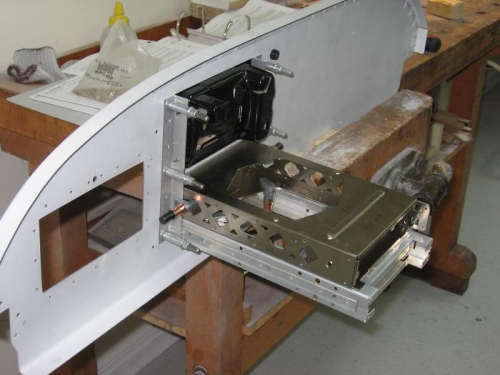

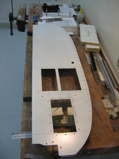

I started the day by laying out and cutting the holes for the Garmin SL-40 comm and GTX-330 transponder followed by the hole for the air gizmo dock that will hold the Garmin 496 GPS. Then I cut some stock aluminium angle for the radio stack side support and drilled the angles to the instument panel. Then I drilled out the air gizmo dock mount holes to the support angles and clamped the SL-40 and GTX 330 trays together and to the support angles in preparation for drilling.
Comm, Transponder and GPS mount holes cut in the instrument panel
Support angles drilled to the panel and radio trays positioned for drilling
