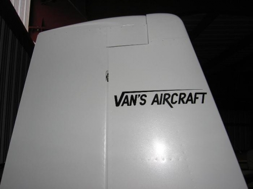

Van's Aircraft Logo installed on the vertical stabilizer

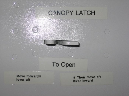

Canopy latch placarding installed inside and outside
