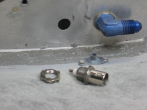

Brief Description:  Right fuel tank defective BNC connector removal
After having opened the right fuel tank yesterday and leaving it to vent today I put a light and mirror into the tank, removed the sealant around the BNC connector for the fuel quantity indicating system harness, unscrew the BNC connector nut and de-soldered the connector wire. Then I cleaned up the BNC connector bulkhead hole. Now I'll have to wait for Van's to deliver the new BNC connector that I ordered.
Right fuel tank fuel quantity indicating system harness defective BNC connector removed
