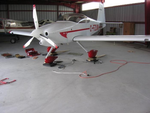

Today was a big day towards the finishing of the project. The aircraft was officially weighed in at 1130 pounds. Also the empty weight center of gravity was calculated and the MD-RA official Weight and Balance forms were filled in. As well I installed a 0.8 AH SLA battery for the P-mags for engine starting as the buss voltage was too low during the engine cranking. Now the only things that are left are the compass swing and the final inspection.
Longitudinal level was within 0.1 degees and lateral level was with 0.5 degees
The aircraft was towed up three ramps onto the weight scales
Weighting in process
