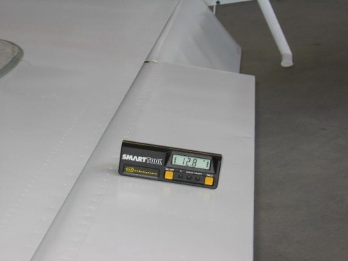

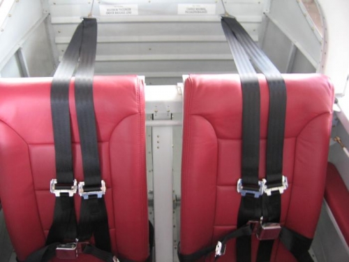

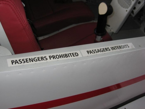

After having had the engine ground strap issue a few weeks ago I was curious to get an actual measurement of the resistance from the crankcase to the firewall so I started today off by putting a meter between the engine and the firewall. It read less than 1 ohm. Next I fabricated the 6 F-7116 bushings required for the seat belt installation and then installed the seat belts. Following this I installed the right flight control control stick. I also installed the "Passengers Prohibited" placards for the flight test peroid. Then I took the readings of the flight control deflections for the final inspection requirements. Lastly I experimented with putting material under the main gear tires to lift the main gear to attain a longitudinally level fuselage in preparation for conducting the weight and balance for the aircraft. I determine I require 2.25 inches under the main gear tires to have the fuselage level.
Seat belts installed
Passengers prohibited placards installed for the test period
Flight control deflections measured for the final inspection requirements
