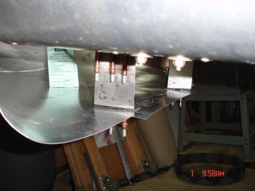

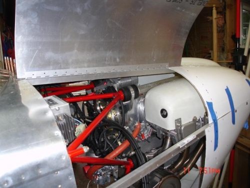

I rolled the cowling tops to get some form to them then drilled out for rivets. Using the cardboard pattern I cut out where exhaust should come out and test fit it and looks like I hit it. I will have to figure out how I will drill the 2 inch hole at the right angle for the exhaust pipe.
