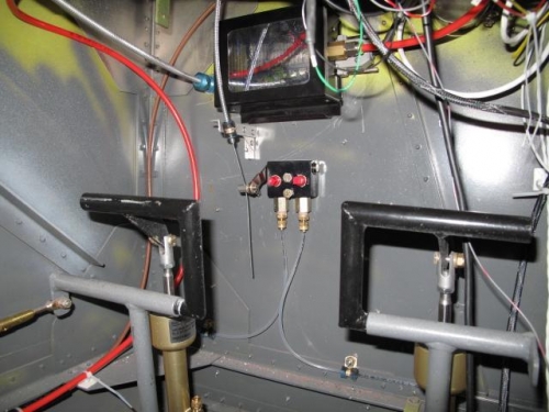

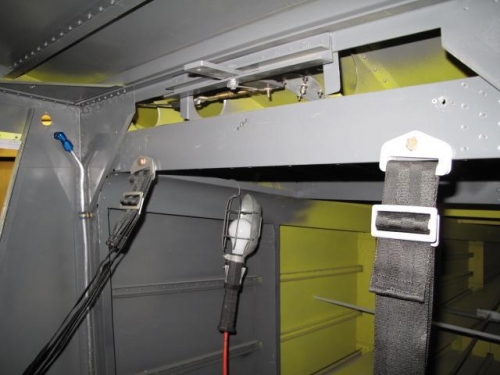

Today was a great day to work on the plane. I ran the brake lines up to the parking brake valve and installed the two master cylinders on the rudder pedals. I had planed on running the 1/8” brake line out of the master cylinders with a straight fitting but found a bracket from the firewall to the rudder pedals would limit rudder pedal travel. So I ordered two more 90 fittings and will continue the brake install then. After much thought on the shoulder harness installation I finally decided to install a 1”x 1 x ¼ angle behind the forward bulkhead of the fuselage to anchor to. I riveted this in place to add strength.

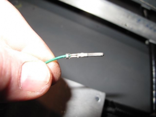

Crimping the conector pins
pull cable hooked up to parking brake
Installed shoulder harnes
