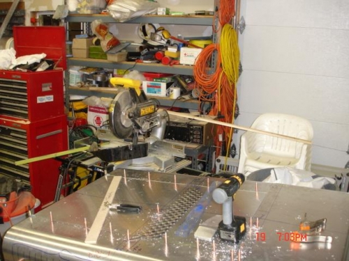

Brief Description:  Use the rivet spacer gauge for drilling perfict ri
Don came up with this idea and it is so good you do not have to center punch for drilling. Just drill out the small holes in the gauge and then drill the first hole and cleco the guage in place then the second hole and cleoc it. That will hold the guage in the p;roper place with the spacing you had it set to.
