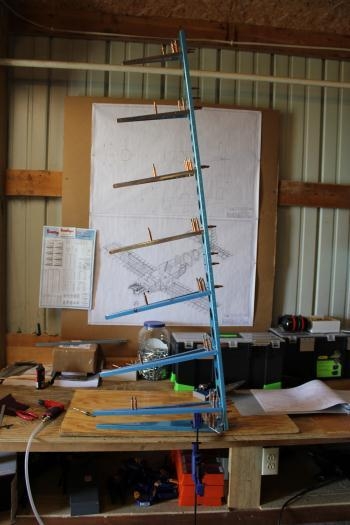

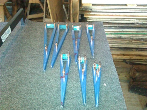

Step 1 Cleco R-1015A-L / R to Shear clips. Match drill common holes to stiffeners and shear clip
Step 2 Repeat for all stiffeneres and shear clips
Step 3 Cleco shear clip/stiffener assemlies to R-1002 spar
Step 4 Cleco the R-607PP and R-608PP reinforcement plates
Step 5 Final drill all holes of the shear clips and reinforcement plates common to the spar web using #30 drill.
