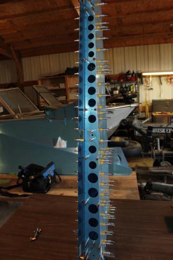

Step 1 - Cleco R-1012 conterbalance rib to R-1002. Final drill two holes that attach the rib to the spar.
Step 2 - Cleco together the R-1003A/B to form Top Rib and rinal drill the common holes except the spar attachment hole with #30.

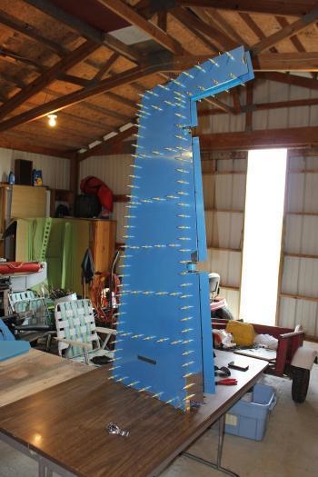

Step 3 - Debur edges of R-1001 skins and cleco 1 skin to the rudder skeleton.
Step 4 - Cleco R-1006 trailing edge to R-1001 skin. Mark area of trailing edge that hangs over skin and sand or file to remove excess.
Step 5 - Clecoed second skin in place
Step 6 - Final drill holes common to R-1001 with #40 reamer. Marking each hole as I move from the center of the spar outward in both directions.
