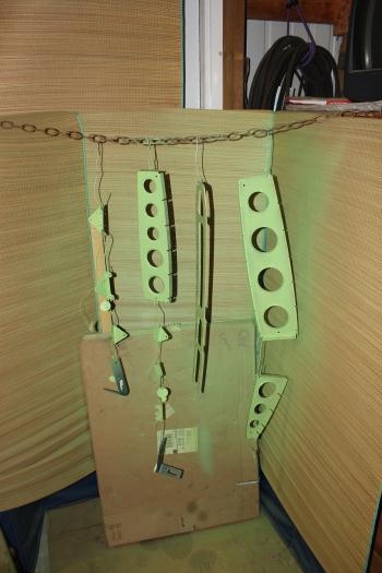

Used Alumiprep and a Scotbrite pad to clean all parts of the VS and let dry.
Image 1 parts were dipped in Alodine for 3 minutes and then rinsed and dried.

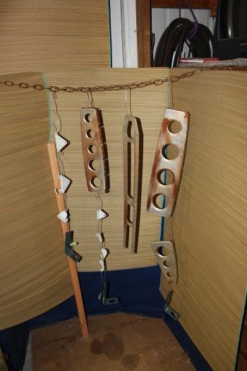

Image 2 the parts were primed with Boeing 10P4-2 & EC-117S. Two part epoxy primer.
