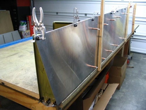

Began right rear side fuselage placement
I began the process of placing the right rear fuselage skin. When I have everything set, I'll be in a position to drill the rivet line to match the bottom longerons.
Looking aft
Clamped to the HT frames
Boards to hold things steady
