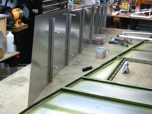

Brief Description:  Drilled L angles for right rear side
I worked on the right rear side panels tonight. This involved marking the centerline of the L angles, placing them behind the rivet line, drilling to #40 then #30, marking the length, measuring down the appropriate distance from the top of each, cutting, sanding and then deburring all holes. For the picture, I clecoed the upright Ls and clamped on the top longeron.
L angles for right side, with longeron on top
From the front looking back
