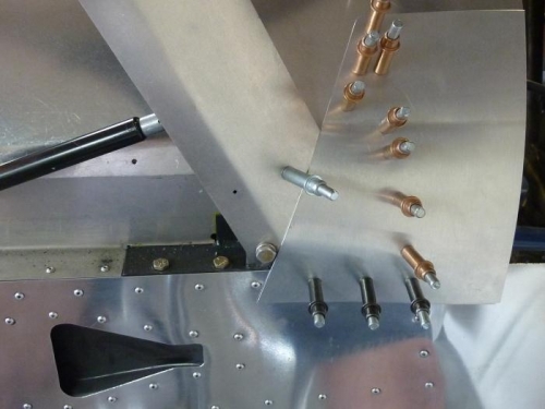

Brief Description:  Made cover for canopy hinge gap - right side

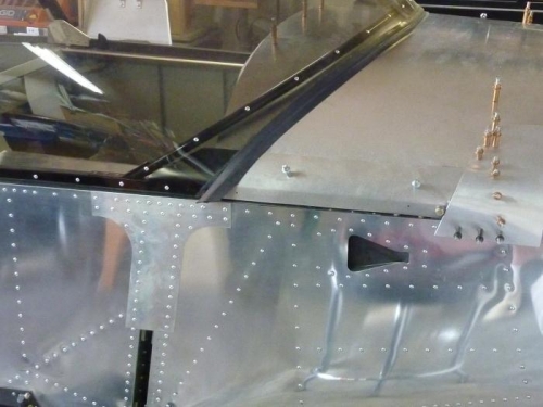

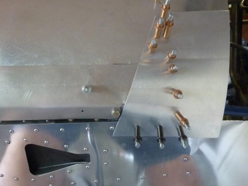

Sleeping on problems often results in new and better options. I was thinking I might have to remake the forward top skin which would have been a major undertaking. I woke up this morning with the idea of creating a patch large enough to catch all the adjacent rivets into the firewall flange but that would blend in cosmetically. After a bit of experimentation with paper templates, I crafted this simple piece, gave it a slight crease to widen the opening for the canopy hinge, and used a hole finder to locate and drill the necessary holes. It works really well, and covers the most unsightly part of my project to date. I predict that once the cowling it attached and everything in this area is polished, this part will blend in beautifully. Now I just need to make the same part for the left side of the plane.
Canopy hinge gap covered with new patch
Close up showing slight crease in new part
Canopy up
Canopy up
