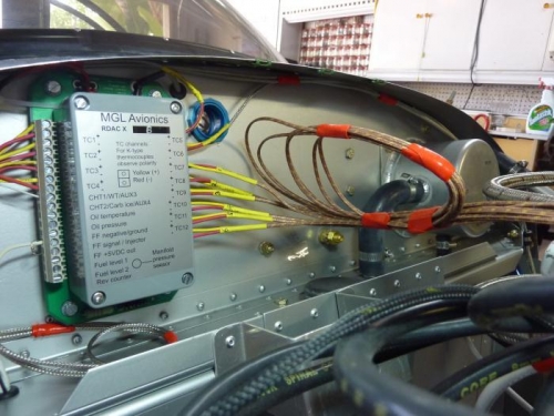

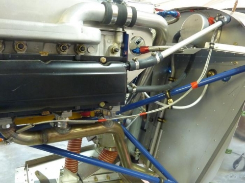

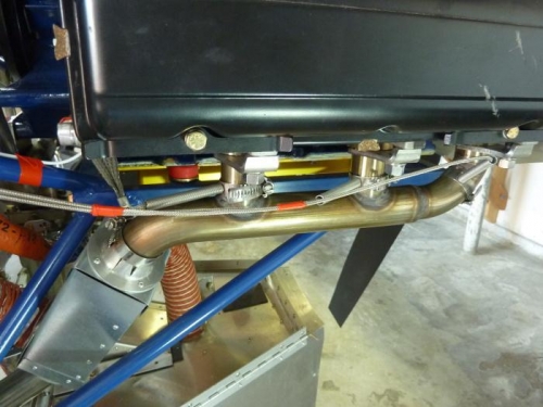

Brief Description:  Installed EGT probes and wired RDAC X
As promised, I'm back from my meetings and travels, and very glad to be back in the shop. Today I drilled holes in my exhaust system for six EGT probes. Next came routing and connection of the leads. Finally, I completed routing and connection of the CHT leads as well. Now I'm set up to monitor cylinder head and exhaust gas temps on all six cylinders from day one.
RDAC X wired for EGT and CHT senders
EGT senders on right side of engine
EGT probes and routing on pilot's side
