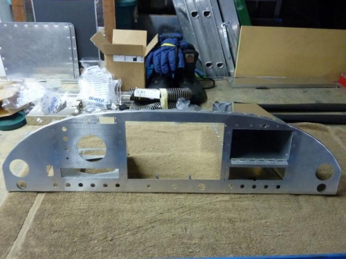

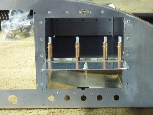

Brief Description:  1 - Riveted panel and map box
I started out the evening with the realization that my heated pitot system (Gretz Aero) has a 3-LED indicator array that needs to find a home in my panel. I elected to place it to the left of my ELT, so I positioned and drilled for that first. Next I countersunk 33 holes for flush riveting the mounting frames and supports. Then I riveted the map box, followed by flush riveting of the panel front. The last task was installing the camloc in the map box frame. Tomorrow I'll start by leveling and mounting the transponder mounting tray in my support frame. Once that is done, it is time to paint the panel.
Almost ready to paint
Repainted interior
Repainted interior
