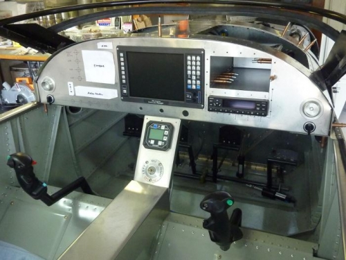

Brief Description:  Installed Voyager, vents and DC outlets

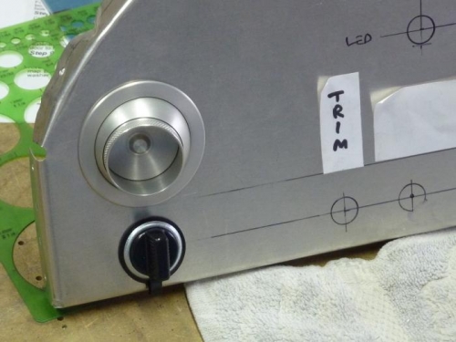

Peter McGowan's grandfather is an aviation guy from way back...and a homebuilder. When he visited some time ago, he offered for me to use some aviation punch sets that he had. These use a 3/4" hole through your material, then a punch and die that sandwich the metal with a 3/4" bolt through them all. Tighten it with a wrench and voila, you have perfect hole. I was able to us these on both the vent and DC outlet holes today. Thanks, guys! As you can see, I also cut my opening for the MGL Voyager EFIS. It's lookin' good, and more like an airplane by the day.
Getting there
Getting there
Vent and DC outlet
Vent and DC outlet
