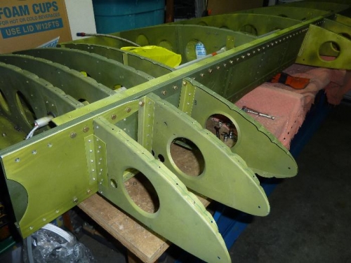

Brief Description:  Completed and bolted wing mods

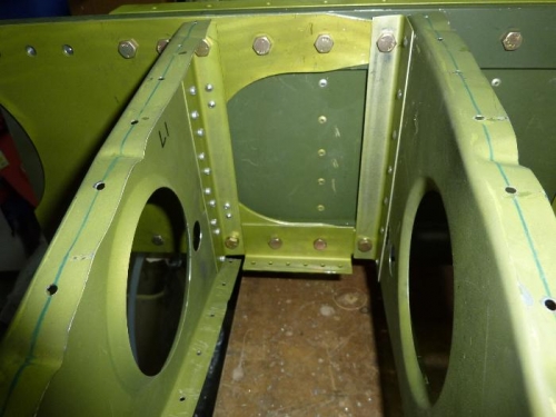

This work session was spread over two days. I completed a careful deburring and edge smoothing procedure to insure there were no nicks on the new extrusion. Then on to priming. Next came the riveting of all the angles. Finally, I inserted and tightened all bolts. All that remains is to torque them to spec.
Ready to torque and move on

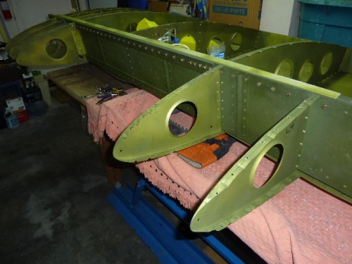

A much stiffer structure around the wing root
Looking inboard
Looking inboard
