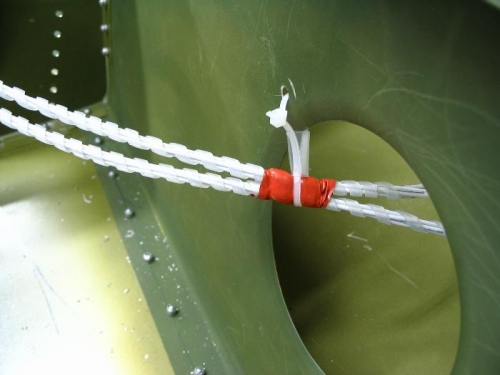

Brief Description:  Finished wiring right wing & started deburring
I completed all the wiring and plumbing on the right wing today, including crimping the Molex connectors on the landing light and wires powering it. You can see how I routed the wires below. I also slightly shortened the aileron bellcrank threaded rod and tested the fuel gauge. Finally, I replaced the top skin, drilled all holes to #20 and deburred the top of the skin.
Wire protection coming out of the conduit (OB end)
