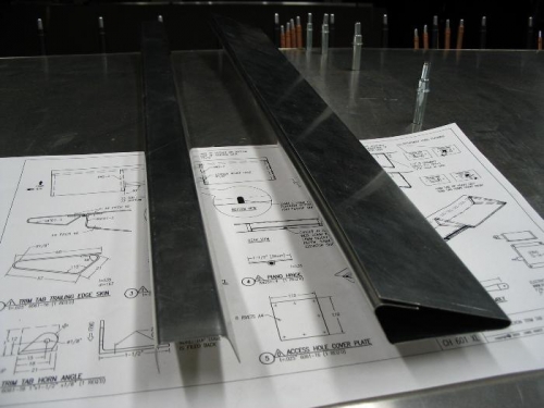

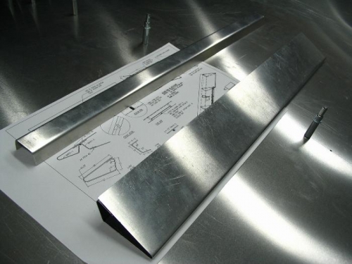

Brief Description:  Made trim tab trailing edge skin and channel
Before I can complete the right wing, I need to fabricate and install the aileron trim tab option. The first step tonight was bending the trim tab trailing edge and the aileron cutout channel. The tab took two tries, but came in very close to perfect. The channel is good, although possibly just a bit to tall. I won't remake it until or unless I can confirm that when temporarily placed in my own aileron. For all I know, my aileron might be a bit tall/thick. The joys of scratchbuilding.
