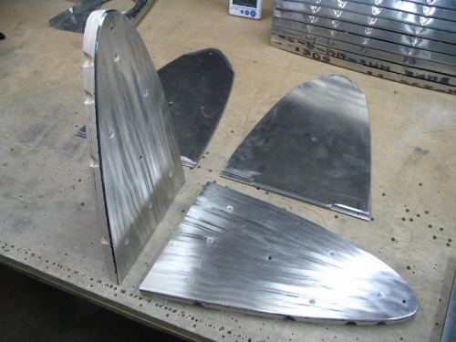

Brief Description:  New nose rib form with metal faces

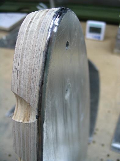

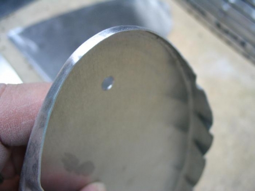

On my lunch break today, I gathered all the supplies necessary to make my new nose rib forms, per the plans as provided by ZAC. I guess I thought I could use hardwood and get around this step, but no such luck. Because I had already cut and trimmed all my blanks, I had to spend extra time making absolutely sure that everything aligned with those blanks. Had I been starting from scratch, the job would have gone faster...but not fast enough to offset the time of cutting all new blanks! Everything came out perfectly and I bent one rib just to test things before calling it a night. Now all I have to do is bend a dozen more ribs and I'll be on to the next thing. There's always something to look forward to.
New and improved nose rib forms
Close up
Close up
Technique up to standards
