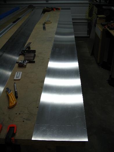

Brief Description:  Cut web blank for right OB spar
Started on the 2nd right OB spar by cutting the web blank. I took great care to maintain the critical dimension of 212mm width. I marked 36 locations along the web (every 100mm) and checked each of these with the digital calipers until they were all within 0.1mm of each other.
Blank cut, filed and polished
