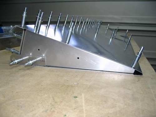

Brief Description:  Final drilling on right aileron
After marking the middle of the rib flanges, I placed them in their correct locations. Unfortunately the 2nd and 3rd ribs (from the inboard side) were slightly long and needed to be trimmed. I placed them and made a mark for each end hole (closest to the trailing edge), removed the ribs and then measured a minimum edge distance from the actual hole. I then trimmed back to this line. In this way I was able to safely shorten the ribs and they fit better the next time. I then pre-drilled the ribs (front, bottom, then top) using the 13mm spacer appropriately at each step. To provide the most stable work surface and to protect the clecos, I used my steel beams and placed the spacer between the beam and the workbench. Next I cut the hinge to length, placed it, double and triple checked my washout spacing and then drilled. As a double check I removed the clecos from the bottom side and placed the aileron on the workbench to check washout. It was perfect!
Inboard end with horn in place
View from inboard end toward 13mm washout
